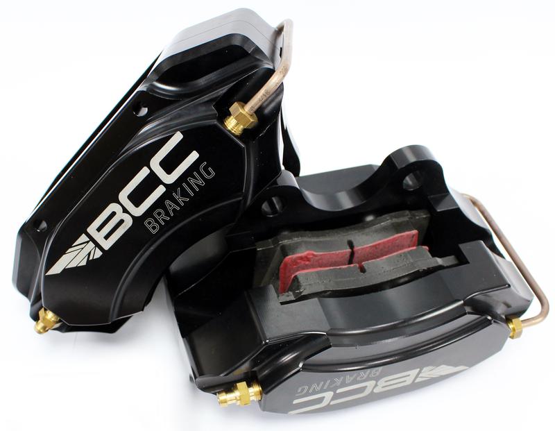

                    Or these might be interesting
                    Bring your classic car brakes up to modern standards with our UK manufactured Triumph Spitfire Mk3 Front Brake Caliper Upgrade Kit. Bolt-on replacement with no modification. Extensively tested to ensure optimum performance.
