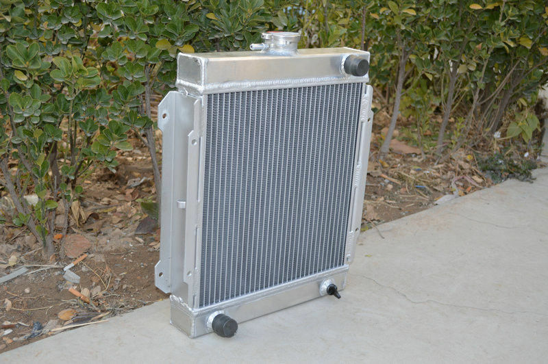

                After loads of Ebay browsing I think I have found a suitable radiator. Of all things it's from a Datsun 1200 which seems to be very popular in Czechoslovakia.
                The core size in ccs is similar to that of the Austin 1800 albeit a little narrower and taller which should actually make fitting easier. The old tired Austin 1800 radiator that came with the car is a squeeze between the chassis rails. And the hose connections are in the correct place (top right and bottom left) and are the correct size!
                datsun1200_radiator by Robin Martin, on Flickr
                It's about £150 direct from the manufacturer in Czechoslovakia but on top of that there will be VAT and import duty making it more like £200.

                    Thete is also this listed for a 1200 Datsun. Its dimensions are slightly different although 3 core.
                    Warranty: You will receive what's in the picture 1 year warranty against Manufacturing Defect. Description: Fit Vehicle: Datsun 1200 B110 A12 / A12T 1970-1976 Manual Fit Manual Transmission Core size 330 mm×330 mm×56 mm  3 rows Overall size 380 mm×440 mm×80 mm Inlet/Outlet 28/28 mm          ROW: 3 Meterial:   Aluminum
                    Obviously go for whichever has the largest cooling surface area.
                    As both are 3 core, will you have clearance for the Grille and a slim fitting electric fan?
                        There are several vendors offering that particular radiator all in Czechoslovakia. I suspect they are all made by the same company whoever that is. The pictures certainly look the same.
                        The core is 50mm deep according to the dims so hopefully should allow for a slim fan to fit behind. Or probably in front even.
