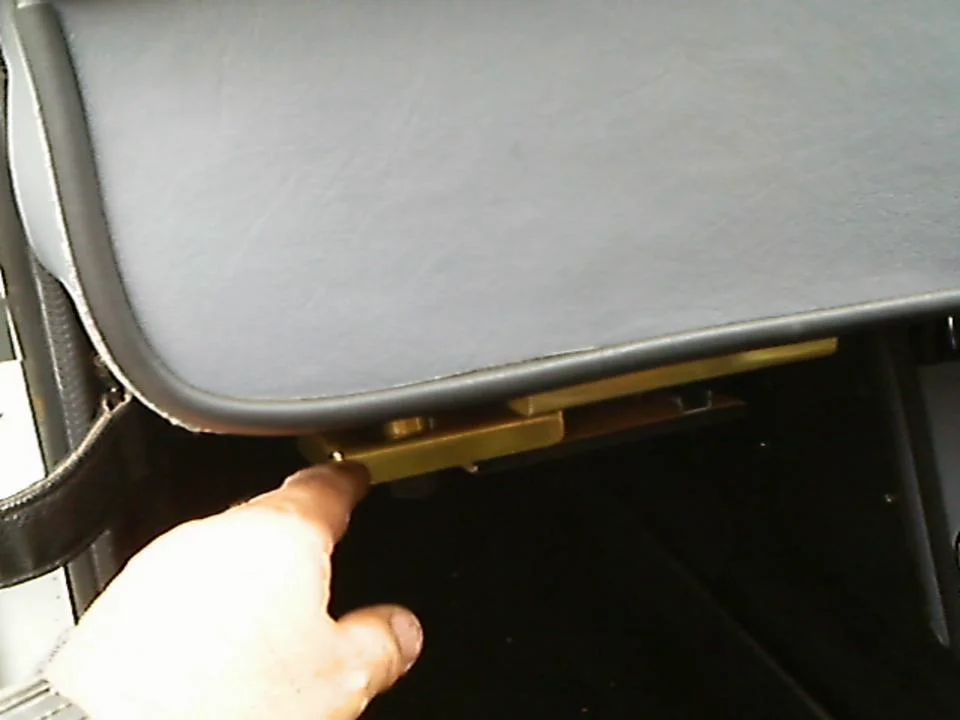

    I needed something that could be fitted permanently but hidden away so I designed and built this...
    Here is a picture of it fitted... honest is is there
    OK I will prove it! here are a couple of views of it in the open position.
    This one shows that from the drivers side what is on screen cannot bee seen, so when you do not have a navigator beside you it has another trick.....
    So there it is, just the camera to fit and retune the radio to the correct frequency and mrs rog will have all her creature comforts!
    Linky to movie to show how it works, the click is from the catch that holds the slide back out of the way until needed, note that as I had a camera in my other hand I left the clamp loose for one handed operation.
    I wanted to have a satnav that wasn't stuck to the windscreen, I wanted it to be hidden away when not in use. The movie shows what I came up with... well…

            OK, this is more difficult to explain than I thought it would be, I have reduced the sizes of a number of pictures which I hope will give enough info to build your own version.
            There are three laminate pieces (cut from a spare laminate floor plank)
            They are:-
            The mounting plate which is held at the back by screws through holes drilled in the bracket in the baulkhead and at the front with woodscrews up into the underside of the dash.
            The slide out plate which is attached to the top of the 2 slides and holds the satnav mount.
            The bottom plate which is attached to the underside of the 2 slides and, using three wooden spacing blocks, attaches to the mounting plate
            picture below shows the slides, slide out plate and the bottom plate....oh, and the catch....
