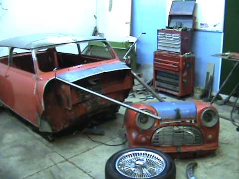

        Have a look at this guy (50 seconds into video) and you'll see why!!
        ....................but he has got a set of lovely wheels though!!
          Re: Avo coil over shocks and cracking noises
          I was close to that once thats why I have spring compressors.
          But he has got some nice wheels and the finished project looks interesting.
          Nice find Mike.

            If he does the same when removing the other spring, his face would look even !!!! Nice wheels..........
