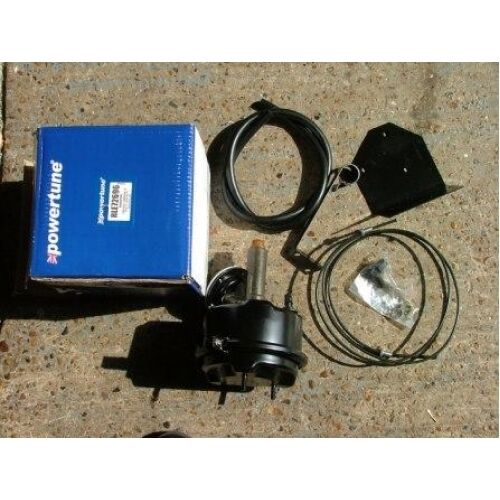

        You could go the same route as me and fit a remote servo.
        I've already got a new kit I bought for another car but this seems to be the average price.
