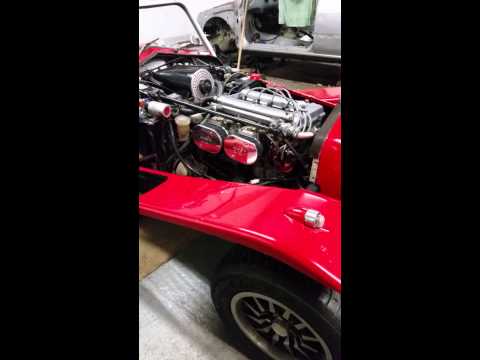

                    I saw this on Youtube and thought of you. I little bit of inspiration for you.
                    https://youtu.be/NRbLafpjmu
                    Mk2 SWB Marina Roadster with a 1800 Fiat Twin Cam engine and 5 speed Abarth gearbox built in 1987
                    - I have no idea what I am talking about........ but my advice is always free! -
                    • dbazdavies
                      • 409
                      Re: Marlin Mon Amour Part 2 !!
                      Wow wonder where that was taken ??? there cannot be many Marlins with an Alfa engine and the spare wheel in the front right hand wing - could be my original car !!!
