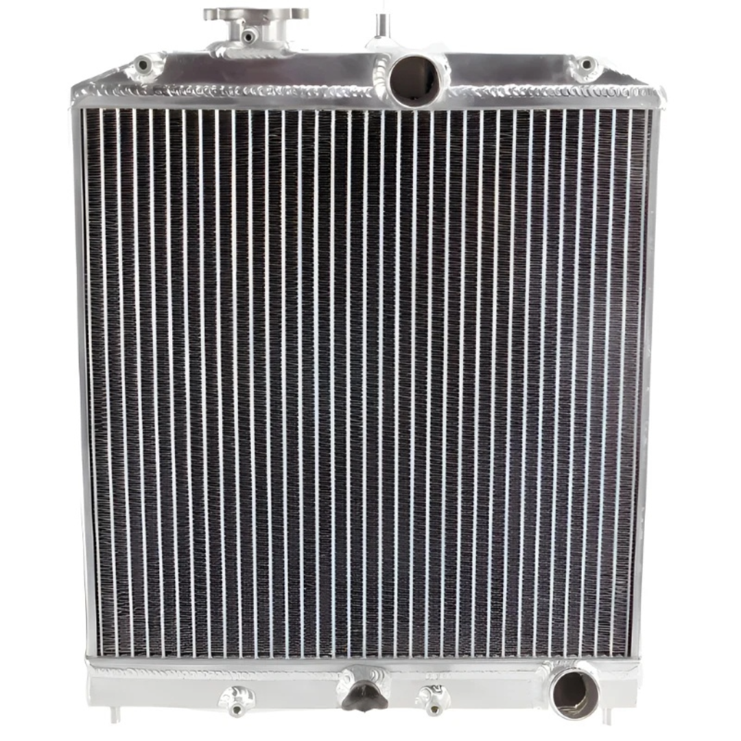

              Maybe I should go for this...
              A beautifully made, all aluminium, radiator with 32mm inlet and outlet. Width - 360mm (14"), height (including cap and bottom mounts - 460mm (18"), thickness (not including inlet and outlet or mounts) 55mm (2 1/8"). Mini pressure cap supplied 1.1 bar (15 psi). Four, M6 threaded, aluminium mounting pillars welded on rea

                  Possibly, I need to change it anyway as both the top and bottom inlet/outlets are on the wrong side resulting in that thermostat housing reversal and a very dodgy looking flex' type hose looping under the front of the engine to get to the bottom hose connection. All very dodgy looking.
                  What's the current 'best practice' thinking on radiators for MK2's with a Triumph 6 in them?
                  The obvious one is a GT6 radiator as that looks to be narrower than a Vitesse but does it fit, I'll have to try and find the dimensions. I wonder if I can get a GT6 rad modified to take the Vitesse 6 remote header tank.

                    The CBS rad looks like a good option as long as you can get it to fit. Rimmers do a GT6 rad outright price steel £250 alloy over £500 phew.
                    Have seen a couple cars with the GT6 rad fitted but not sure whats favourite, mine has the Vitesse rad with the chasis monts removed and it hangs on the studs that originally held the engine side bay panels. It also has the top outlet resoldered straight so to connect the top hose. Another member has a 2.5 car with the early Vitesse 6 set up but not sure how the rad is mounted.
                    I think even a Triumph Dolomite rad wouldnt be too far off the mark.
                    It might be worth having a chat with a local radiator service to see what they suggest.Have a look at ebay item 251031139402 Brisca F2 copper 3 row this chap makes them to order there is a telephone number/
