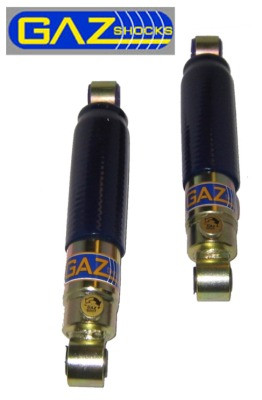

                  Re: Roadster shock absorbers
                  When my original front Spax wore out I fitted a pair of Gaz shocks, part # GT4-2270...they are usually a fair bit cheaper than Spax and I've been impressed by both their longevity and performance.
                  British Parts NW have them listed, albeit currently out of stock. They also list a standard damper. Moss Motors in the US list standard versions & Spax and Rimmer Bros in the UK list Spax, Koni and Gaz alternatives for the stock part # GDA4011.
