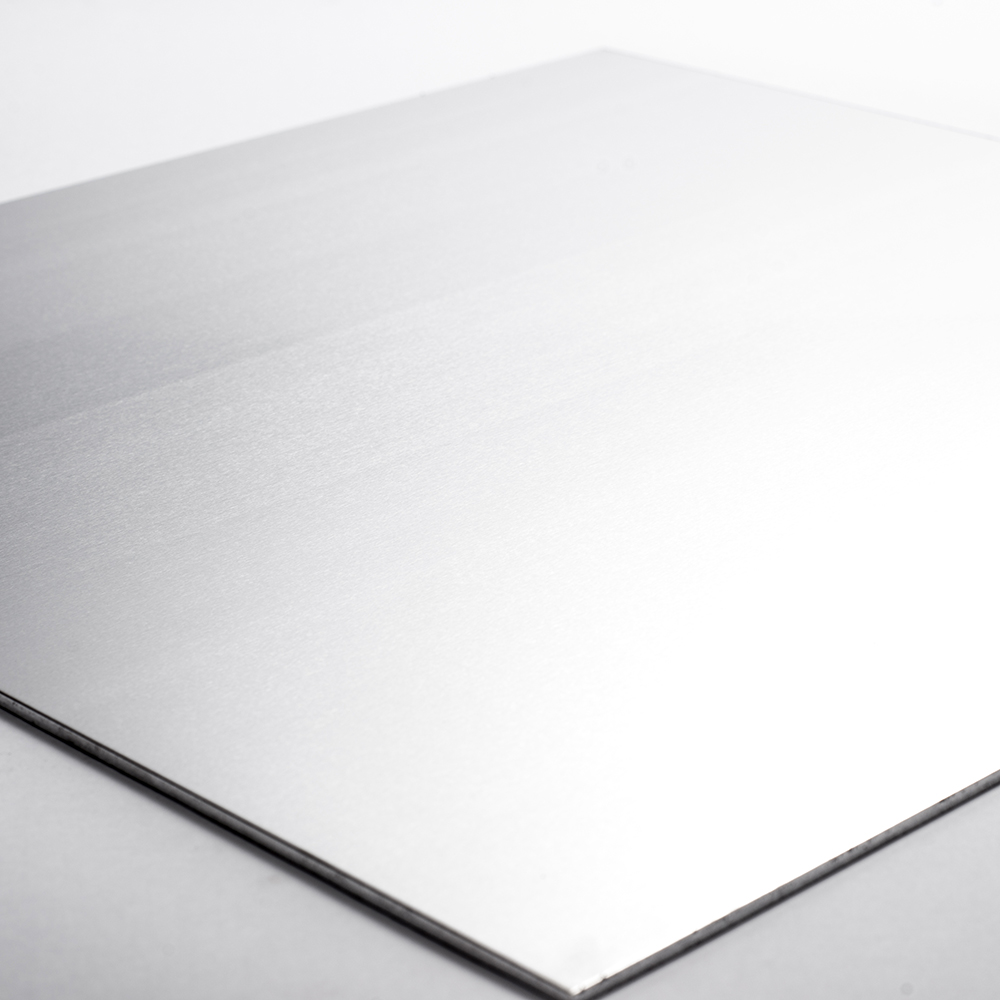

    With regard to the stress cracking, I have come to believe that some if not all of the bulkheads may have been manufactured badly.
    Sheet aluminium has a grain structure usually denoted by the direction of identification printing on the sheet.
    If aluminium is folded too sharply along the direction of the grain, it is inherently likely to stress crack. If two or more sharp folds are close, the chance increases.
    If sheet stock aluminium was originally cut to get the best use of a whole sheet, to manufacture several bulkheads, without reference to the grain structure, this again might be reflected in the apparent randomness of the cracking occurring.
    Without having engineering drawings available, it's unlikely that my conjecture can be proved or disproved.

      Mine cracked diagonally out from one of the corners in the transmission tunnel opening.
        #18
        Re: Marina brakes
        That is unusual, to me.
        Could that confirm my theory?
        Did someone just put a template up against the largest sheet they had, that was not long enough so the template fell at an odd angle?
        It would be curios to do a survey in Pitstop and/or online to see if there is a pattern of failure modes.
        But I guess those that were spotted early have the bracket fitted.

              You might not be totally wrong, it may explain those cases where the cracks run along the folds.
                #22
                Re: Marina brakes
                May also depend on the grade of alloy sheet that was used back then as Spec 1050A-H14 seems to be a better bet!
