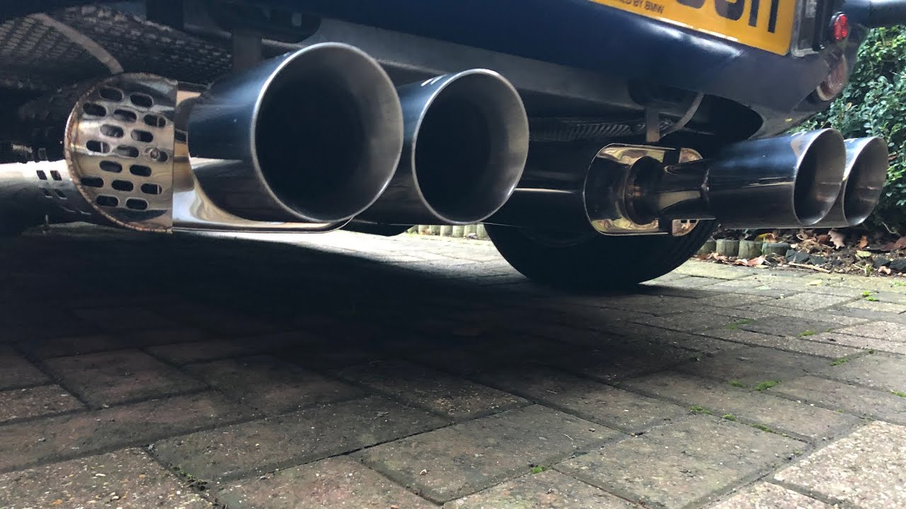

      Car down on the ground from a low angle, the exahust tips are closer together than before (due to the input on the backbox being offset rather than in the middle).
      The tips stick out a little further than the old ones, the wall thickness and slash cut work quite nicely.

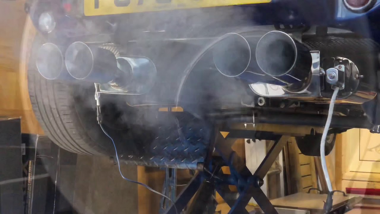

      Temporarily wired up the control box, and now for the noise test:
      Closed it’s quieter than old the jetex micro bullet muffers + the large magnaflow boxes. Open it’s a bit of a beast, louder than before so that should be fun! It's pretty much were I wanted it to be, will see what it's like on the road once the wiring is done.

          Video (obligatory no exhaust clip right at the end when everthing was off):
