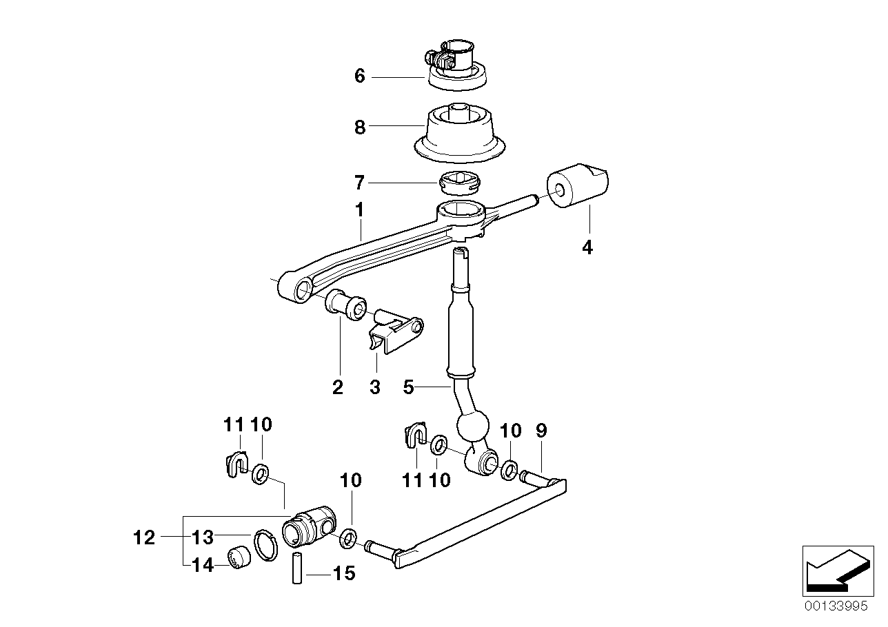

    The alternative is to unhook the part that holds the stick - part 3 in this diagram, push up to release and pull out from the side plus the linkage in the bottom of the shifter, part 11 then pull part 9 out. That should let you drop the gearbox without taking the plasic bit out. Not sure how easy it is to get to with the gearbox in the car though.

      Cheers Patrick this is a big help ------with all the accumulated muck it was difficult for me to see how the fixing at part 3 works but the diagram made it easy With the prop shaft off and part 9 disconnected I was able to pull part 1 together with lever still attached. It was a lot easier getting the bearing out on the workbench
