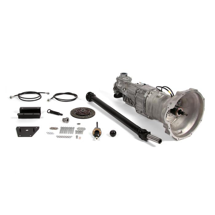

            Originally posted by dogoncrazy View Post
            Why not a Mazda box on to the B series .
            £2665 + VAT Unless you DIY it..!
            Change the way your MGB drives with the Vitesse MGB Gearbox Conversion Kit using the proven Mazda MX-5 Mk3 5 Speed Transmission. The MGB gearbox kit is suitable for all 1962-80 MGBs. Now with a period correct black gear knob the gearbox perfectly complement your B's interior. Read our MG ENTHUSIAST FEATURE.
