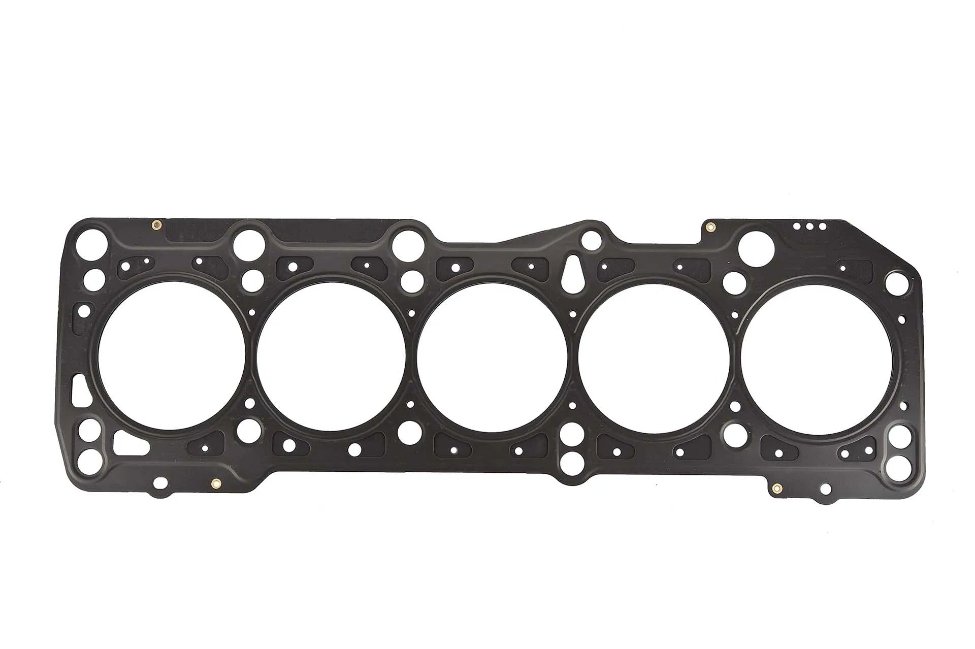

                    Head is off and thankfully only a gasket required, which I will order this afternoon.

                      It looks like the bores and pistons are in excellent order.
                      According to this Haynes web site
                      Head gaskets are the most stressed gaskets in an engine, because they have to deal with multiple tasks at the same time. They simultaneously seal oil, coolant, and engine compression, therefore when they fail, they can fail in a number of different ways. Each failure will result in different symptoms.
                      “The most common cause of a blown head gasket is engine overheating.”
                      I think problems with cooling lead to the demise of my own Pinto. Possibly, due to hot spots caused by flow problems through the Marlin’s unique cooling system. It might be worth trying to clear the waterways as much as possible and check the pump.

                              Head gasket replaced yesterday. The car is now running but I have to advance the timing way in advance of the timing marks.
                              I'm thinking that if the (new) rotor arm is incorrect, turning the distributor would bring it back but the timing would be correct.
                              So I'm wondering if I've got the camshalf one tooth out (although it looked right) so moving it anti-clockwise will correct it.
                              Or, might it be the new inlet manifold gasket letting in air?
