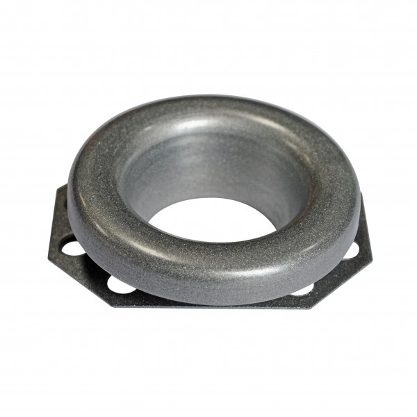

                You can get low profile stub stacks that will fit inside and air filter
                MED STUB STACKS | MED (med-engineering.co.uk)
                Should have read to the end of the thread before posting​
                  • 2449
                  #23
                  You could use these and just have some wire gauze behind them to catch the larger bugs.
