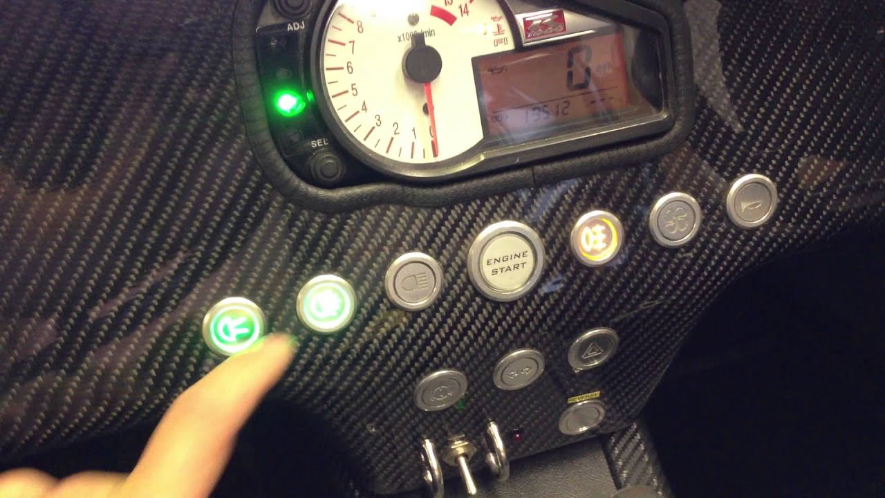

      Just when I thought the finishing line was in sight, the IVA rules on the Foglight switch have changed.
      Previously the rear fog was only allowed to be on when the main lights (dip/main beam) were on - not with the side lights. This was easy to achieve, taking +ve from the main/dip circuits to the fog switch and out to the light and earth.
      Now the rules state that when the mains are switched off, and then back on again, the rear fog must not come back on again inadvertently: ie it must be deliberately switched on again.
      This is not a simple circuit to solve - I thought a simple latching relay would work, but then I can not switch the fogs off without switching the main off !
      The only answer I have come up with is a kit from Cartek:
      This video demonstrates the controls perfectly:
      It's easy to install.
      The only problem is its £40 including switch and p&p!

              Fog Light Control Switch
              .............doesn't look much for £40.00 does it?
              But, I have to have it to pass IVA, and it looks easy enough to wire in.
                It took 20 minutes to wire in - an hour all told to re-tape the wires and then test.
                Worked first time straight out of the box: it could not have been easier.
