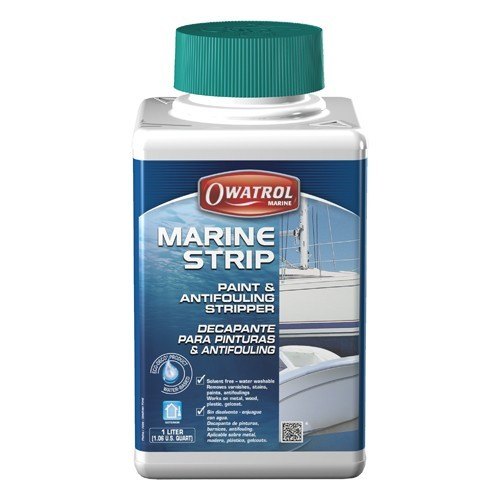

                Marine Strip is a powerful water-soluble paint and anti-fouling stripper designed for marine uses which can remove a number of coats in just one application. It is perfect and safe for use on boat gelcoats It is safe to use on virtually any surfaces...
                elbow grease works well!!

                  Thanks guys, pondering on it
                  I ran out of elbow grease doing the rear tub, checking stores for more supplies LoL

                    I gave up on the gentle technique so went animal with a strip disc - thanks Cameron
