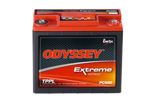

              With this little baby you don't have to worry about size.

                Re: size of battery in A/H
                what is that!!??
                  Originally posted by marlin munroe View Post
                  what is that!!??
                  I believe that's a high A/H motorbike battery, a lot of the Lotus 7 facing fraternity use them as they are both small and reliable, plus I believe they are solid state so you can pretty much mount them how and where you want. On my wish list.
                    • 2445
                    Its the battery in my Marlin. Powerful, reliable and small. This has been my battery of choice for two years now and the car starts on the button and is around the same cost as a standard battery.
                    Can even be oriented upside down.
                    Great battery and don't know why modern cars don't use them.

                      • 929
                      Which brand did you go for?
                        • 2445
                        The baby you require is a Powervamp Odyssey PC680.
                        This will easily turn anything upto a two litre engine.
                        For £99 you get battery and aluminium braket.
                        They are small, compact and can be mounted in any orientation.
                        P.S. It's what I have used on my Roadster.
                        See thread http://www.marlinownersclub.com/foru...hlight=Battery
                        There is a picture of the install there, I covered up the gapping hole for the original and mounted it on the bulkhead, now the passenger has some foot room.
                          I cant read the manufacturers name ..the retailer seems to have badged it with his own markings
                          what is the model number, and the ampage?
                          If its the one I think it is, then is only about 16 amps? but supposed to be able to crank at 1500amps for 5 seconds.......I dont understand how it works
                          And if I purchased something that just looked like it ( apparent size and shape and position of terminals) it could be of ANY rating?
                            • 2445
                            The company that makes them is Powervamp, the model is Odyssey and the model number is 680. I don't profess to know how they work, they just do. I had one in my 1.6 Marlin for 4 years and never failed to start the engine. I have had this battery in now for two years and again excellent.
                            My Marlins are left out in all weathers and I have never taking the battery off the car. They are compact, powerful and I would recommend them to anyone.
                            Link
                            Used on Formula Renault cars it will deliver the cranking required on high compression engines up to 3.5 litres.
                              The cranking amps is limited by the batteries internal resistance and is independent of, although related to, its amp hour capacity. I guess Oddesy use a technology that means the internal resistance is kept low. Which explains the cost....
