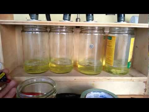

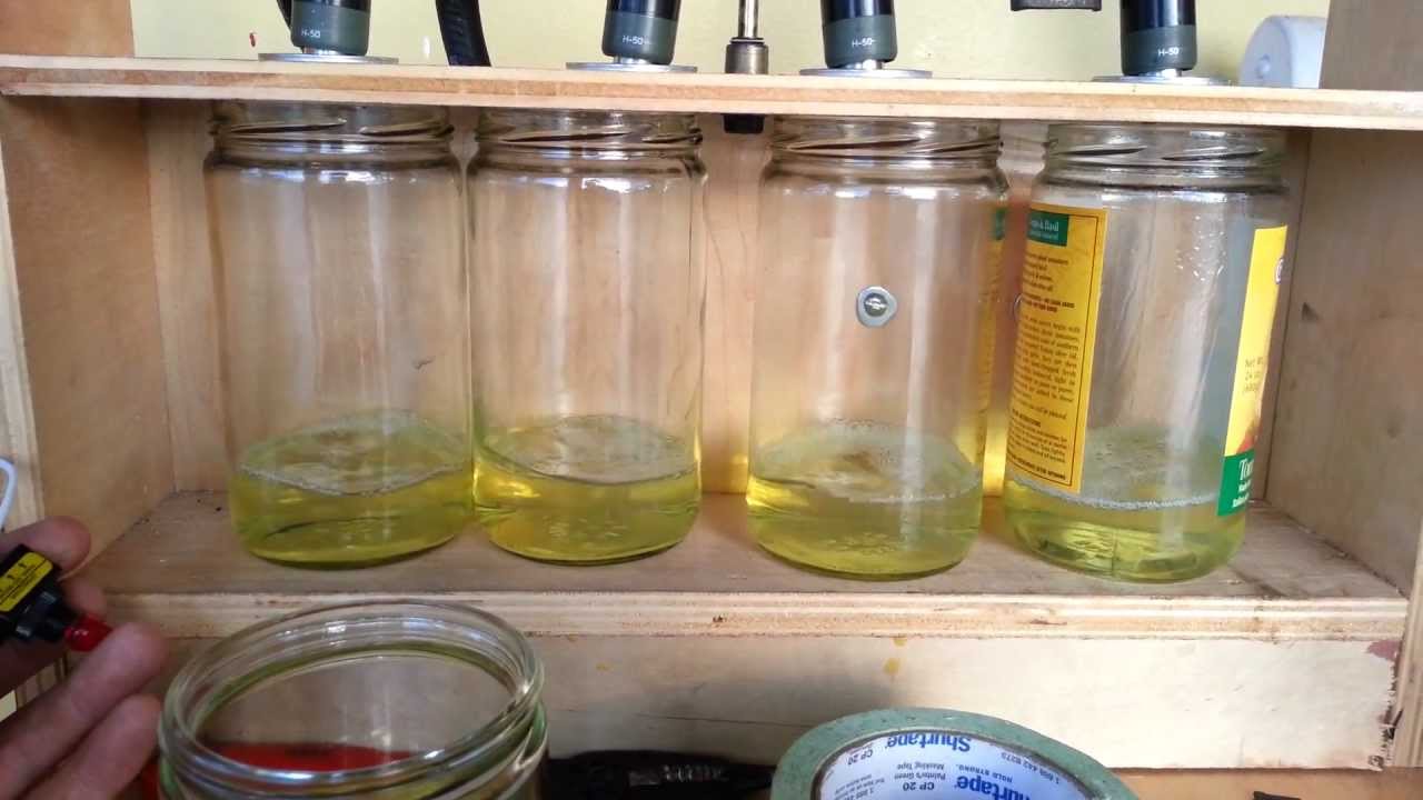

          Re: Mark II – Engine woes
          I came across this
