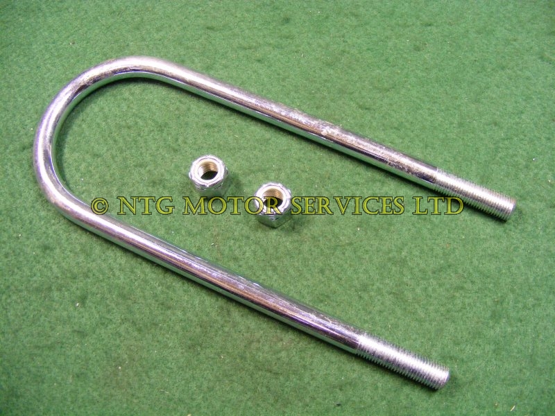

    A company called Grayston used to manufacture extended U bolts for the Marina, but they discontinued them many years ago.
    However - the Ford Escort Mk1 & Mk2 has U bolts with the same curvature as the Marina and Grayston continue to manufacture extended U bolts for them, the U bolts are 50mm longer than standard.
    A point of information, the Ford U bolts are made of a slightly bigger diameter steel than the Marina ones, so you will need to drill out the Marina/Marlin spring plates to suit the Escort U bolts.
    They can be purchased here https://www.demon-tweeks.com/uk/gray...steel-gryge25/
    I hope that this helps.
    Chris
                Chris
                That was useful information thanks. The only Escort U-bolts I had found were uprated 5/8" which would have been a challenge to get to fit with the standard spring plates. I've ordered a pair as mine are very corroded.
